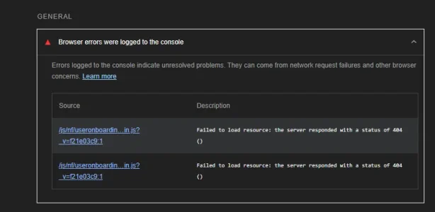

Also. Were there changes with the js path? Not sure what code is calling for this source. I'm getting the following issue in Chrome console:

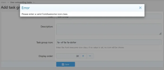

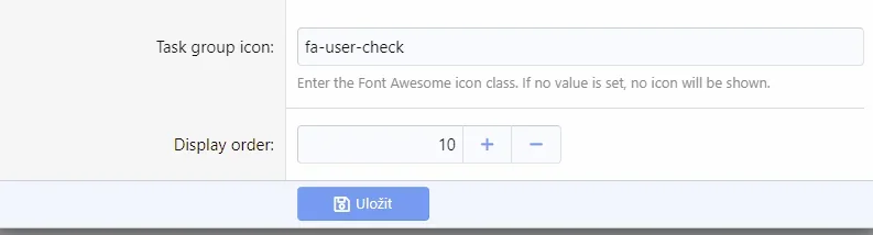

Quick question, what syntax is the task group icon field looking for? I've tried a bunch and I keep getting the same error (trying to use fa-dollar/fa-usd).

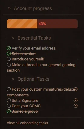

So what does this mean then?
The following tasks are available out of the box:
  • User has set an avatar.
  • User has set a profile banner.
  • User has set a signature.
  • User has entered a value for a particular custom field.
  • User has linked a particular connected / external account.
  • User has created a thread in a particular forum.
  • User has replied to a thread.
  • User has replied to a specific thread.
  • User has verified their email address.
  • User has purchased any user upgrade.
  • User has enabled two-factor authentication.
It says it comes with tasks out of the box. Where are these tasks?
Thanks
The add-on can be extended to add additional task conditions through either the XF user criteria system or by extending this add-on with another add-on.
The bit you quoted refers to the task conditions that come with the add-on. You'll still need to enable the ones you want at Admin -> Users -> User onboarding tasks -> Add onboarding task -> Simple
You can also create tasks using XF user criteria by using the advanced task type.
