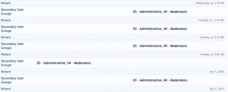

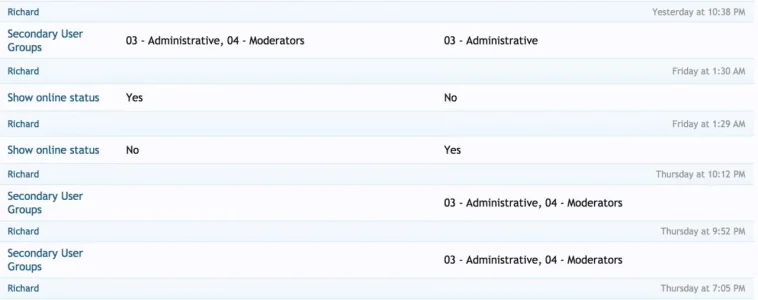

I don't have any user group promotions running. I checked the user log, and it just has "Old value" = "blank" "New value" = "Admin, Mods". This is has happened a few more times that I've actually realized.
Screen Shot 2015-04-12 at 19.16.18.webp Screen Shot 2015-04-12 at 19.16.40.webp
You can see where the old value is blank, then the groups are being added.

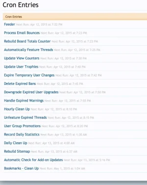

These are my cron entries
I believe the only add on ones are for "Bookmarks" and "Featured threads", but I've had these installed for a while now without any issue.
Is there anywhere else that I should be checking for cron tasks?
