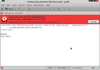

I've been trying to properly mount the XenForo AdminDAV share on Ubuntu 10.10, but something just doesn't work right. The share is mounted successfully, and I can browse all the css/html templates. But any changes that I make to a template are not saved.
Editing via nano just silently fails. And using gedit produces this error message:
AdminDAV is probably not the culprit here, as I can successfully save the template when the share is not "mounted". Could it be a permissions problem? Here's the setup:

gedit shows there was an error while renaming the temporary file.
But the temporary file wasn't created in the first place?

#1. After much searching and debugging, I've found that neither AdminDAV nor the share mounted via davfs is at fault. It was gedit. The component which you least expect to be wrong! Here's the bug report:
https://bugs.launchpad.net/ubuntu/+source/gedit/+bug/34813
(Reported in 2006! Affects smbfs, cifs, sshfs. And now davfs as well.)
#2. Figured out how to disable locking in davfs. Now I can successfully save the templates via nano. Gedit appeared to work, but it never saved the file. The DELETE request went though, and the last PUT request failed: effectively deleting the template.

#3. It's a good thing the last PUT request didn't succeed. If it did, a new template would have been created for the 'default' addon ID; which would be even harder to notice. As if the template deletion wasn't a major WTF already. Damn it, gedit. I want my 4 hours back.
tl;dr: Don't use gedit when dealing with files in network shares mounted via fstab. Nano and Eclipse work well. :)
