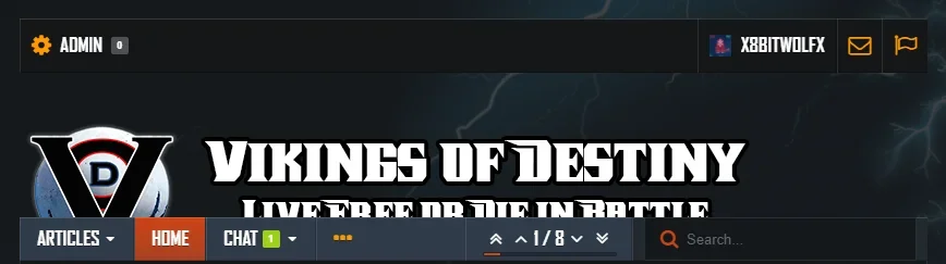

I've been used to use a smaller logo, with low resolution to make it fit in the header - but now I want a better solution, but please help me here :)
How do I make it fit?
I believe here you just need to tweak logo height under Header and Navigation style property group.

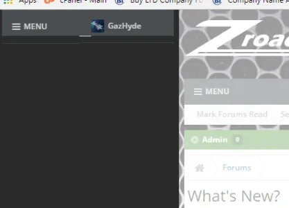

Just had my forum updated to 1.5.14, and updated the UI.X add on to 1.1.2, then downloaded the latest templates. The responsive menu has broken, getting this on iPhone & iPad and also on reducing the size of the window in Chrome?
Any thoughts - appreciate it's early on a Sunday morning though ;) ?
