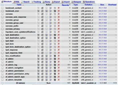

Now when I run a previous backup to see wether or not the import process will work I suddenly get an SQL error (see picture). What is it telling me?
fredrikse
It seems like error 1064 refers to MySQL can't create tables. When I import the db I get this error. Then when I look in phpMyAdmin I see that there actually are a few tables that have been created. But suddenly it just stops.
Edit: It turns out that I have a problem with my internet uplink connection now as well. When I looked in FileZilla I saw that the upload of the DB almost had stalled. And that's why I got the SQL error :)
