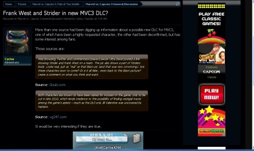

Here's an image of what I mean, Keep in mind, this is a default thread display, the old ad placement is on the top, the new one [the one without the border] is on the bottom, you will see the difference.
To see another thread example, here it is.

Well that makes sense doesn't it? There's no sidebar on the thread view normally - you're creating one with the <xen:sidebar> tag, and you're putting an ad into it. It then displays the sidebar with the ad you explicitly put into it as well as the ad in the ad location template.
If you want to force the sidebar on that page (without the duplicate ad), you'll have to add the <xen:sidebar> tag (and give it some sort of content, such as <div></div>).
yoghurtfarmer
Add <xen:sidebar><div></div></xen:sidebar>
Thread view doesn't come with a sidebar normally, that's why the ad doesn't show up.
When you add in your old code, you've now added the sidebar to thread view, so the new ad will show up. But since you have your old ad code within the sidebar tags, you end up with 2 ads.
