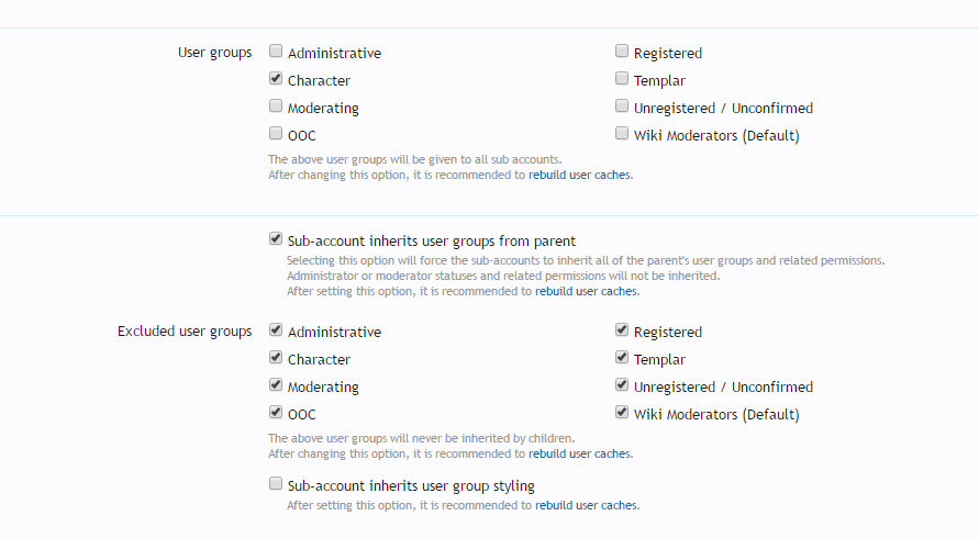

Sure! There were actually two different usergroup issues, and the fix addressed one of them as far as I could tell.
The other one is related to this setting:
After setting that configuration, I rebuilt the user caches, but none of the subaccounts were assigned the Character Usergroup. I created a brand new subaccount as well, and it also was not given the Character usergroup.
However, the usergroup inheritance from the parent account is working fine now.
Hey do you have 'Sub-account inherits user groups from parent' enabled, since enabling that fixes the issue :)
Okay, I tried enabling that and now subaccounts are given the correct usergroup.
However, it doesn't seem to make sense to have the "parent usergroup inheritance" control a setting that has nothing to do with inheriting the parent account's usergroup. I don't want my subaccounts to inherit the parent's usergroup. I just want all subaccounts to automatically be given the usergroup.
Right now this is the only way to make it work the way it looks like it's supposed to, which isn't very intuitive:
It works at least. But if you're looking for improvements, I'd just recommend detangling that setting from the parent inheritance, because it doesn't look like the two settings are connected at all and I feel like they aren't supposed to be connected.

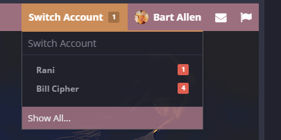

I noticed that the alerts at the top of the account switcher aren't showing the cumulative # of alerts from subaccounts anymore. It only shows 1 no matter how many you have.
