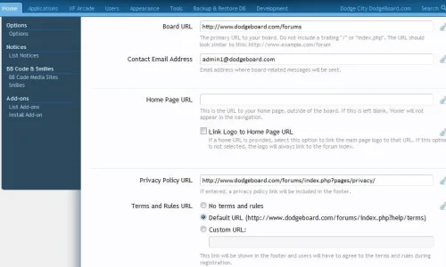

If I login to my testforums, and make any change at all (or even an upgrade of my testforums), my URLS become confused on my LIVE forums. All of my registration emails start going out with www.dodgeboard.com/testforums in the URL and when I look in the admincp of the LIVE forums, the URL has changed in some places, but not all. The contact URL changes and the Privacy URL changes but not the BOARD URL. It stays as it should.
Screenshot of my live board after upgrading my testforums:

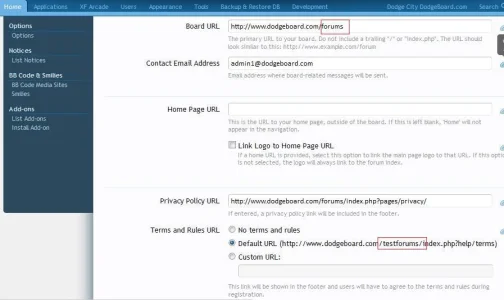

All I have to do to fix it is change the board URL (to anything) then hit save. Then change it back. Then the URLS correct themselves as follows:

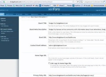

My testforums (FROM MY TESTFORUMS ADMINCP) settings look to be correct:
