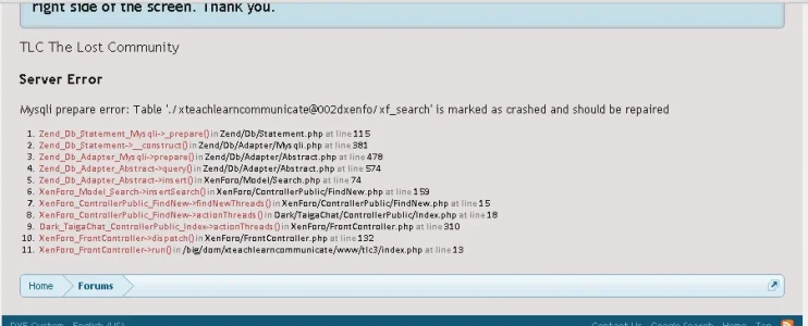

I clicked on my What's New this morning and get the following message. See screen shot. I would be greatly appreciative is someone can direct me as to what I need to do to repair the table noted. Thank you.

Run the repair utility in cPanel via the MySQL Databases icon/link.
Then you may want to consider rebuilding the search index.
