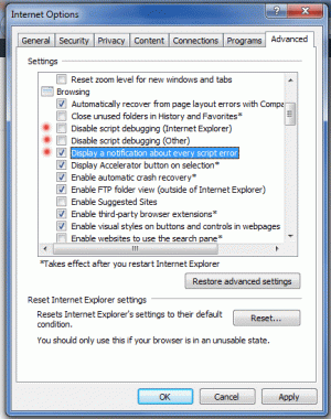

FYI - if your users are reporting the "please enter valid message" error, I could not recreate the error until I changed the following settings in IE9.
Make sure the 3 settings marked below in IE were as per the screen shot
* Uncheck "Disable script debugging (Internet Explorer)"
* Uncheck "Disable script debugging (Other)"
* Check "Display a notification about every script error"
and then when I was logged in to the forum and viewing a thread, the error
Line: 283
Error: Object doesn't support property or method 'context'
popped up. Then I typed a message in quick reply and tried to post it and I got the error "Please enter a valid message" and it wouldn't post.
I've disabled all plugins on my main board and this issue still exists.
Hope this helps someone else in trying to sort this out.
