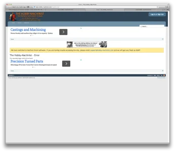

Do you have some permission errors happening? I get:
Could explain some Google issues you're having, thus subsequent traffic problems??? People can't get into your site, let alone search engines from the home page.
