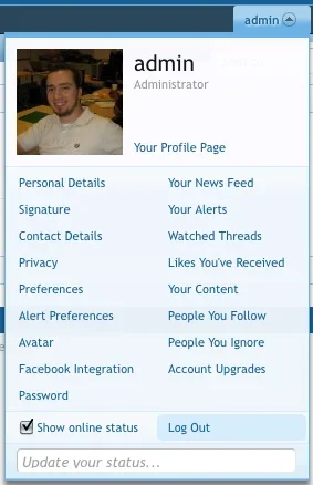

however if I use this "Log Out" link the confirmation box is still removed but it doesn't redirect me to my portal? have I missed something ?
Thanks again
