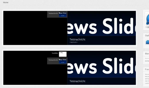

Hey sorry 8th.. reallife can be crazy as hell... I started the work on that module thursday but I had to work over the weekend so I hadn't time to do anything.. can you test this module to see if it works? I had no problems... It gives you the option to select the forum you want to add.
AltSlider.php belongs in library/EWRporta/Block
Haven't time to pack it correctly.. probbably I'll release a more proper version during this weekend.. as long as it works..

Thanks but it's coming up blank. http://www.the8thlegion.com/forums/media-reviews.109/

Strange... I'll review it today... do you use something different than 'slider.jpg'?
I forgot to set the cache for the module.. you should add it (1 hour).. will change for 1.1...
I have a screenshot of the two sliders on a test site.. here it is working.. strange..
i apologize. i used slide.jpg not slider.jpg. i'll try again.
#12
on my theme , it displays improperly the left side. can someone tell me how to fix? www.coconutbeef.com
heres altslider code
