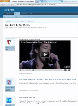

Hi!
I have two threads that start with a posting with embedded media. Both threads show only the first postings in Firefox: forum.computerbetrug.de screen capture 2011-6-19-1-6-39.png
In Safari both threads are shown in full: Safari.png
Both pictures show different threads but the problem is the same: in Firefox even the "edit" link is missing.

What the *meeeeeeep*?
I truely believe you, but here on FF on Mac I just see the first post and even that one not completely.
I see all posts on Safari and Opera, and the picture stays the same (cut-off thread) in FF. Last try: reboot.

Same situation after reboot. The thread is cut at the end of the first post.
I started a third thread and the behavior is still the same. Is there anything we can do to find the reason?
