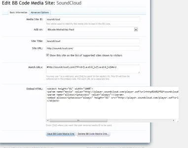

Ok, I've added the addon and what happens to me is this:
1) I paste the soundcloud link into the thread (ex: http://snd.sc/GEXiDA)
2) It 'recognises' the code and post is made...BUT,
3) It keeps a url link in the post ;-(
Fellas, I need help (not hope), on this... Here's the link to what I have soo far:
http://sck-mobile.com/community/index.php?threads/test-02.1414/

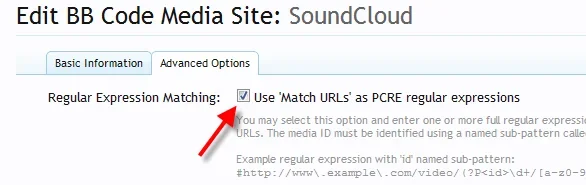

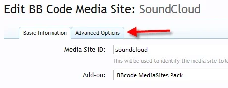

I'm an idiot. On the Advanced tab, you have to check the box by:
Regular Expression Matching:
  • Use 'Match URLs' as PCRE regular expressions

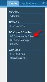

CritiKiL
#15
Ok, I can't even find where the 'edit BB code...' area is? I was just there but this is all swamping me and I can't find where to look in order to check if the 'Match URLs as PCRE regular expressions' is selected or not ;-(
