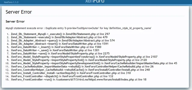

EDIT: I tried again. And I got this error:
Chris D
XenForo developer
Staff member
#10
That particular error suggests it's installing into a database that isn't blank as it says there's a duplicate entry. I guess that would be expected if you'd had a previously failed install.
It's so annoying things like this - I feel for you :( Not fun, and I'm sure your host will keep blaming everything else but them.
Often at times like these I find it useful to threaten leaving, but, maybe even in your case, you should just leave them and go somewhere else anyway...

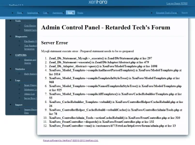

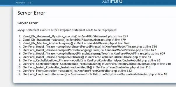

Prepared statement needs to be re-prepared
MySQL problem. See this thread:
http://xenforo.com/community/threads/error-on-install.17901/
Duplicate entry...
Is that during the install? Into an empty database? This is possibly related to the other errors.

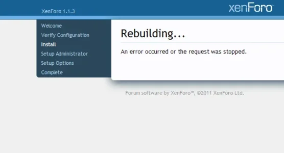

<blank page>
I visited your forum and it's currently showing a blank page. A blank page is often a suppressed error. Try adding this line to your library/config.php file to see if that reveals any specific error message on the blank page:
ini_set('display_errors', true);
