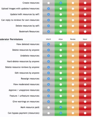

The group permissions are set correctly for the resource category, as far as I can tell (does anything else need to be explicitly set here?:
any idea?
thanks!

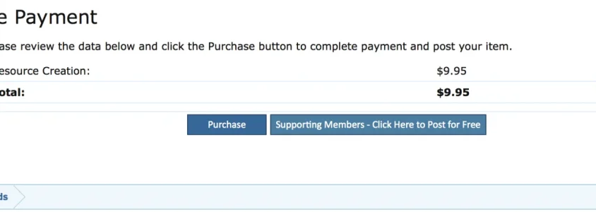

Strange, are they definitely clicking the 'Mark Paid' button on the purchase info page?
Liam
Liam
Yes -- they click the button on the right (which i've relabeled):
And it gives that error, just tried it again myself logged in as the user class with the perms shown above.

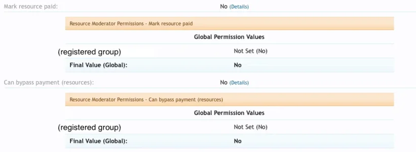

So right now my "registered" permissions for this add-on look like this (ie, they are unset:
And for my "premium" group, which people get added to when they purchase a year's subscription, looks like this:
In theory that premium group's permissions should be overriding the registered user perms, and allowing them to bypass payment. In practice, when I analyze the perms of one of my premium users, I get this:
So it is ignoring the user's premium group membership, and reverting to their lesser group perms. Which XF isn't supposed to do.... I think this may be a real bug in the add-on. Unless i've missed something!
