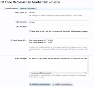

I'm using the "BB Code Media Sites" tab for that.
Sorry, it's in German - but I think you'll get the idea:
The full code for the last field is:
<A HREF="http://www.amazon.de/exec/obidos/ASIN/{$id}/ref=nosim/radioforende-21" target="_blank">http://www.amazon.de/exec/obidos/ASIN/{$id}/ref=nosim/radioforende-21</a>
You just need to change it to ".com" and enter your own Amazon id.
