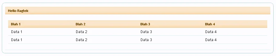

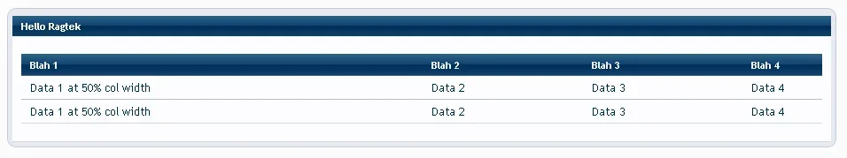

Nothing wrong with using tables, just need to use tables within default xf format for them to look nice :D ... use this format (for quick development) then expand to the class via your own CSS to further format them.
For quick easy development use this format..
<table class="dataTable"> (using dataTable and (dataRow in the tr) is similar to class=tborder)
<tr class="dataRow">
<td> or <th> (using th is like using the tr class="thead")

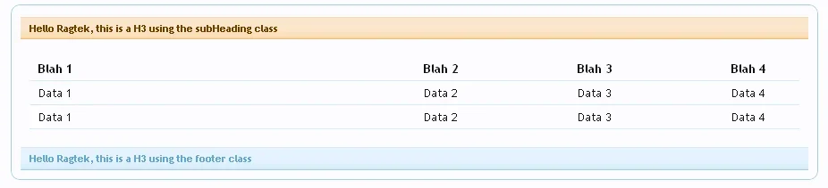

That will give you the BASIC output of tables within the clean usable default xf table format That will convert and place nice with custom styles (see image 2). Also use the col element of the table to specify column widths (see examples below)

Code sample for image 2
HTML:
<div class="sectionMain">
    <h3 class="subHeading"><b>Hello Ragtek</b></h3>
    <div class="primaryContent">
        <col style="width:50%;">
        <col style="width:20%;">
        <col style="width:10%;">
                <th><b>Blah 1</b></th>
                <th><b>Blah 2</b></th>
                <th><b>Blah 3</b></th>
                <th><b>Blah 4</b></th>
            </tr>
                <td>Data 1 at 50% col width</td>
                <td>Data 2</td>
                <td>Data 3</td>
                <td>Data 4</td>
            </tr>
                <td>Data 2</td>
                <td>Data 3</td>
                <td>Data 4</td>
            </tr>
        </table>
    </div>
</div>
Code sample for image 3
HTML:
    <h3 class="subHeading"><b>Hello Ragtek, this is a H3 using the subHeading class</b></h3>
                <td><b>Blah 1</b></td>
                <td><b>Blah 2</b></td>
                <td><b>Blah 3</b></td>
                <td><b>Blah 4</b></td>
            </tr>
                <td>Data 1</td>
                <td>Data 2</td>
                <td>Data 3</td>
                <td>Data 4</td>
            </tr>
                <td>Data 1</td>
                <td>Data 2</td>
                <td>Data 3</td>
                <td>Data 4</td>
            </tr>
        </table>
    </div>
    <h3 class="sectionFooter"><b>Hello Ragtek, this is a H3 using the footer class</b></h3>
</div>

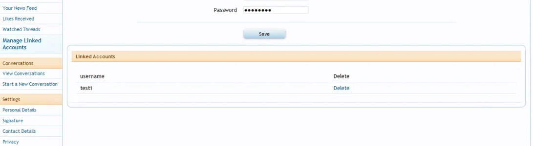

Hm, it's not working for me:(
    <xen:if hascontent="true">
        <h3 class="subHeading"><b>{xen:phrase ragtek_qus_linkedAccounts}</b></h3>
                <xen:contentcheck>
                    <xen:if is="{$associatedAccounts}">
                            <td>{xen:phrase username}</td>
                            <td>{xen:phrase delete}</td>
                        </tr>
                        <xen:foreach loop="$associatedAccounts" value="$user">
                                <td>{$user.username}</td>
                                <td>
                                    <a href="{xen:link qus/qus-delete, $user}">{xen:phrase delete}</a>
                                </td>
                            </tr>
                        </xen:foreach>
                    </xen:if>
                </xen:contentcheck>
            </table>
        </div>
        <xen:else/>
        no associated accounts
        </xen:if>
</div>
shows:
As you see it's not like on your first and second image :( (the table head have no other design)

you need to use <th> and not <td> for the Table heads.. you are using <td> in your table head area..
swap with this...
HTML:
                            <th>{xen:phrase username}</th>
                            <th>{xen:phrase delete}</th>
                        </tr>
