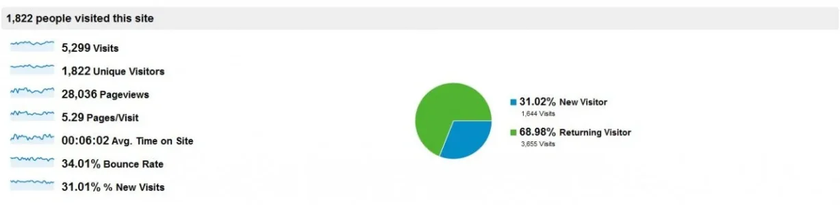

Traffic.... March 4th - April 3rd:-
94,736 people visited this site
220,726 Visits
94,736 Unique Visitors
1,580,382 Pageviews
