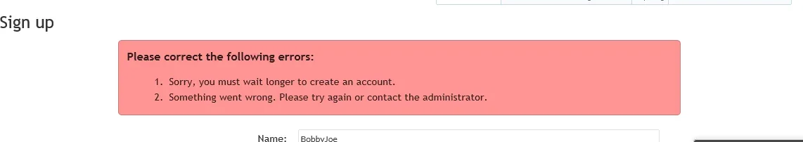

New users trying to register this very strange error when submitting the form successfully. This happens to me as well when I try on a new browser.
