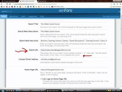

allow me to clarify. Both of my sites are with the same host. all i am looking to do is change the url where the forum lies so that gamentrain.coms url can receive all of the traffic to that domain rather than splitting my traffic between two. I have spoken to a few designers and they seem to believe that the change of url should be a bit more simple.
The image below is what I am thinking of
Where does the domain point to right now? If it's the same server and the domain is not currently being used then perhaps you can just park the new domain on the existing site (done by your host or server person). Then you just need to update the Board URL. No file or db move needed if it's the same site.
