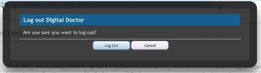

Everything was working perfectly up until I updated to xenforo 1.0.3 now as soon as i click on logout (logged with facebook) i have an intermitent redirection error and both chrome and firefox seems to go crazy retrying logout forever, this bug even happens on this xenforo forum so i assume is a 1.0.3 issue.
