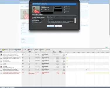

A bit of an update on this. Looking at the code in the SpamCleaner.php model it looks like it is clearly linked to the looking up IP info that is causing the error. Unchecking the check IP box in the Spam Cleaner does allow the other functionality to work properly.
Also, here is a quick screen shot showing what is described in the first post in this thread.
