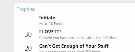

Where are the Trophy icons supposed to show up? Not seeing them anywhere.
I actually can't recall if you have to prepend the fa- or not. You can try leaving it away. I'll look it up as soon as I get to my computer again.
Ok it works after removing fa-.
This is inconsistent with another addon I am using that works with fa- and does not without it. I think including fa- is the correct format according to FontAwesome, at least that is what they show on their website. I could be wrong, but it would be good if the community was consistent, whichever one is correct.
Anyway, it works now that I know to delete this prefix.
An issue with the display is that adding an icon replaces the ability to see how many points the trophy is worth. You could consider moving the points display, or the icon to show both.
Do you have any future plans to use the icons for a postbit display of trophies? I'm hoping someone makes a solution for that.
Cheers!
This is actually inconsistent across XF2 itself. When defining an admin navigation icon in the developer section of the acp, you have to prefix the icon with fa-, but when assigning an icon to a custom bb code, you have to leave it away. Ultimately I've decided to stick with leaving it away, as it is the same interface structure I've utilized. I'll probably be making some improvements to it though, so it just works with both ways.
You can opt in to show the points for each trophy as a text next to the trophy title on the overview page. I haven't done that for profiles yet however, as I am working on accumulating the points for trophies with predecessors before doing so.

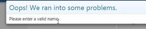

I'm having issues with the Username Changes.+
1st attempt to change names results in
XF\Db\DuplicateKeyException: MySQL query error [1048]: Column 'change_id' cannot be null in src/XF/Db/AbstractStatement.php at line 212
XF\Db\AbstractStatement->getException() in src/XF/Db/Mysqli/Statement.php at line 174
XF\Db\Mysqli\Statement->getException() in src/XF/Db/Mysqli/Statement.php at line 69
XF\Db\Mysqli\Statement->execute() in src/XF/Db/AbstractAdapter.php at line 69
XF\Db\AbstractAdapter->query() in src/XF/Db/AbstractAdapter.php at line 145
XF\Db\AbstractAdapter->insert() in src/XF/Mvc/Entity/Entity.php at line 1381
XF\Mvc\Entity\Entity->_saveToSource() in src/XF/Mvc/Entity/Entity.php at line 1113
XF\Mvc\Entity\Entity->save() in src/addons/KL/UserImprovements/Pub/Controller/Account.php at line 59
KL\UserImprovements\Pub\Controller\Account->KL\UserImprovements\Pub\Controller\{closure}() in src/XF/Mvc/FormAction.php at line 169
XF\Mvc\FormAction->run() in src/XF/Pub/Controller/Account.php at line 35
XF\Pub\Controller\Account->actionAccountDetails() in src/addons/KL/UserImprovements/Pub/Controller/Account.php at line 19
KL\UserImprovements\Pub\Controller\Account->actionAccountDetails() in src/XF/Mvc/Dispatcher.php at line 249
XF\Mvc\Dispatcher->dispatchClass() in src/XF/Mvc/Dispatcher.php at line 88
XF\Mvc\Dispatcher->dispatchLoop() in src/XF/Mvc/Dispatcher.php at line 41
XF\Mvc\Dispatcher->run() in src/XF/App.php at line 1863
XF\App->run() in src/XF.php at line 328
XF::runApp() in index.php at line 13
Clicking Save again then works.
When I try and display the name changes I get the dropdown next to the name, but it just says Username Changes and doesn't actually list any of the changes I've made.
Permissions are set to yes for Admin/Mod/Registered
XF 2 RC3 & User Improvements 1.0.0 Beta 4
