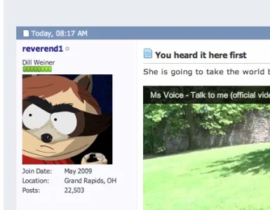

I'm putting together the customizations for my forum (currently vB4 but moving to XF 1.2) and I've been able to find pretty much every tweak my users have asked for here except for the fact that they are used to the posting time and date at the top of a post like it is in vBulletin:
I haven't been able to figure out how to make a change like that in XF but even if it could be moved to under the Avatar that would allow the users to see when a post was made without having to scroll to the bottom of a longer post.

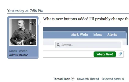

awesome! Thanks! That worked perfectly!

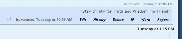

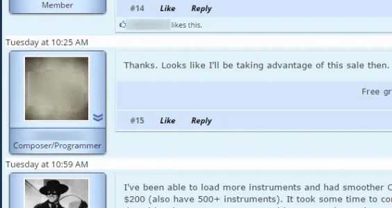

It's working!... BUT, now I need to figure out a couple more things:
1- location to the right, I used float:right, but it's losing its formatting.
2- how to maintain the same dimensions as when I don't add any CSS.
Here is what I have when I just put the code "as is":
Here is what I get when I style it:
This is the code I used.
  <div style="font-weight:bold;float:right;background:transparent;">
<a href="{xen:link threads/post-permalink, $thread, 'post={$post}'}" title="{xen:phrase permalink}" class="datePermalink"><xen:datetime time="$post.post_date" /></a></div>
Now, I can also see there will be 3 dates and times in the same area (2 per post, plus the one that shows that the post if and when was edited. Should I eliminate one of them? If so, I'm thinking of taking out the one beside the member's name in the private controls (to the right of their name).
Is this making sense?
Thanks you in advance!
