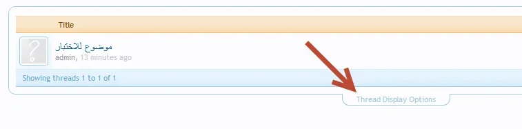

Also, I've searched for xml sitemap for xenforo and found an add-on for that and I want to know if this option will be supported within xenforo itself in the upcoming versions or not?
And what about thread list sort order options in forum sections? it seems that this is not supported yet by xenforo?

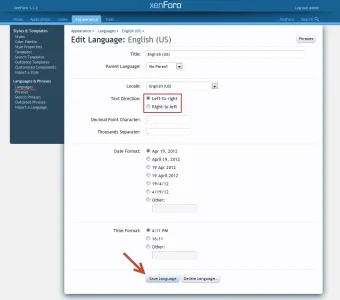

It looks weird in the English language, but if you use the Arabic language it should look better. :p
I changed the language direction as per your reply and still can't see valid Arabic characters when move mouse on thread,forum title and I mean the title portion of the landing url and when I click the link the url will contain the title as rawurlencoded in the browser address bar, I hope you get what I mean :)
