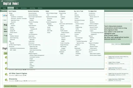

XF 1.2 How to make a dropdown of all nodes, like on https://forums.digitalpoint.com/ ?
It's a little more complicated than a "styling" question... for example permissions have to be taken into account (you don't want users to be able to see stuff they can't normally see).
And it gets *way* more complicated when you realize that the navigation thing isn't it's real purpose... it was just an accidental nice bonus. It's *true* purpose is a drop-zone for drag and drop threads (for mods/admins).
In what way?
From what I can see it is functionally identical, minus a difference in styling which is just CSS.
