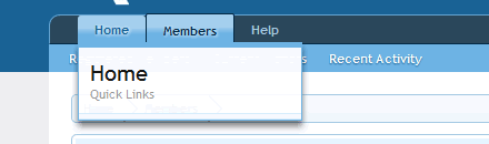

I have hidden the "Search Forums" via the ACP and also hidden the "What's New"-Tab from guests as per your instruction.
However it seems I am doing something wrong, as the drop-down-box still appears at the "Home"-Tab. But this drop-down-arrow only shows the text for "Quick Links".
Is there a way to also hide this (empty) drop-down-box from visitors?
Is there a way to hide all Tabs in the Sub-Nav-Bar and also this "Quick-Links" drop-down?
I would like to only show the 3 Main Tabs "Home", "Members", "Help", but without the Sub-Tabs underneath them.
But I would like to keep the default design of the light-blue background-color of the Sub-Nav-Bar.

The Home tab doesn't have a drop down in the default style.
Do you have any add-ons installed? I suspect it comes from that.

my "Home"-Tab is actually the "Forums"-Tab. I have just re-named "Forums" to "Home" in the phrases.........
I have no add-ons installed and using the default XF-style.
Could you please help me to hide all the Tabs in the Sub-Nav-Bar? I could not figure out where to put the code for hiding those Sub-Tabs from visitors.
