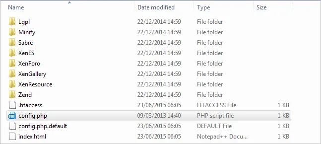

You should add that user-account to adminstrators through the admin control panel. Then in your config.php in your library directory, edit
$config['superAdmins'] = 'user id'; to include the user id of that user-account.

Super admins are defined in the library/config.php file:
$config['superAdmins'] = '1,2,3';

I hate to sound stupid, AGAIN but how do I find the library/config.php file?
I went here Admin CP -> Users -> Administrators
But can't find anything that looks like library?
Hi Danita,
Did you understand Brogan's answer? You cannot get to the file via the forum itself. You will need to log into the server that the forum runs on, and use an editor via a terminal program, or an FTP program to download, edit, and replace that file. I had to poke through the directories to find it, but it is there.
