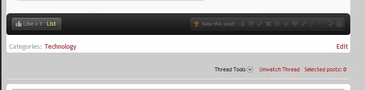

Next step when you promote an article, at the bottom of the post you can choose which category it goes into. Mine looks like this:

Thank you very much for reply. Something similar to your set-up is pretty close to what I'm after. I think my first problem comes at the "promote the article" step. I have XenPorta set up so I have a "News" forum, with threads that display on the home page, but these posts are still displayed as threads (site.com/threads/) instead of as "articles." I've enabled the articles/categories box now, as you instructed.
There is also category section visible when I view an individual thread in the News forum, but when I try to edit it, it says I do not have permission, despite being the administrator. I can't find anywhere where I can set permissions for who can set categories, nor anywhere else that I can set a category. How and when should I be promoting an article?

I could not figure out yet that how to solve category problem
