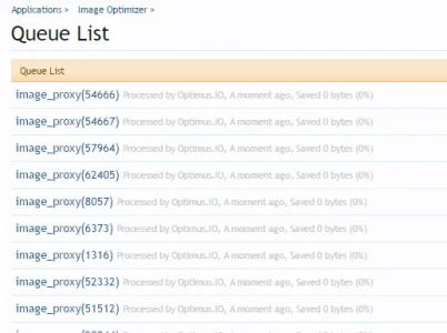

I run that 2 queries but in ACP I can see that Queue list is still going on.
I just do not know is all images proxiy are processed or not.
What is your suggestion?

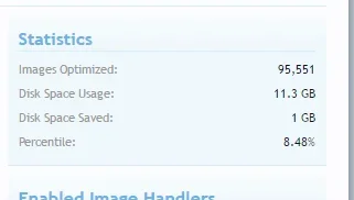

I just want to stop this queue because as long as I can see, there are just allready optimised images, but in statistics count is increasing every hour, and I do not know is there are still not optimised proxy images, or all is completed.
This is run for 3 days.
Is there a to know how manny attachment images I have (include image proxy)?
If i be able to stop this queue what I should not run again so allredy optimised images do not go into queue?
I just want from now, that new attachment images and proxy images get in queue.

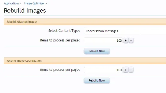

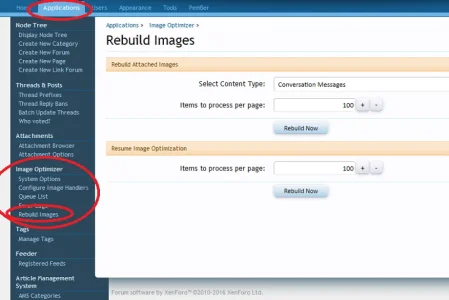

I see mentions of Applications > Image Optimiser, but I don't have this in my ACP... Am I missing something?
I have the caches > rebuild caches > optimise images, but not 'Image Optimiser'

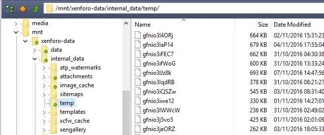

My internal_data/temp/ is full of gfnioxxx files - about 9GB
When that files will be deleted?
Will be deleted in some automatically proces or I have to delete them manually?
The files should've been deleted once the image is processed. You can remove the files there without any issue.
