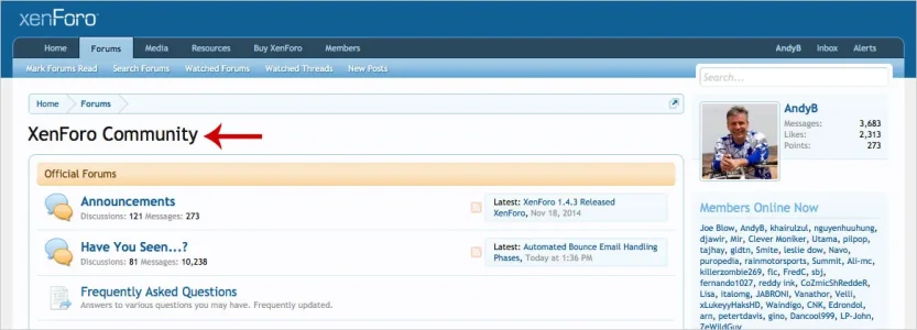

Lack of interest Forums tab should show "Forums" when selected

Most forums show the board title in the logo, showing the board title again a few inches below the logo looks bad and is redundant.
The other tabs show the tab name at this location, it would be nice if the Forum tab did as well.

I just tried editing the forum_list as you suggested in post #4 this and I get different results. On my forum the browsers forum tab shows the board title and the text below the breadcrumb shows "Forums".

Perhaps because this is the most important page in a forum it would be best to use this:
<xen:h1>{xen:phrase forums}</xen:h1>
that way the board title will be shown and will be better for SEO. It would be great to make this change because having the board title repeated below the breadcrumb looks bad IMHO and as you can see others have had to make this change on their forums.
