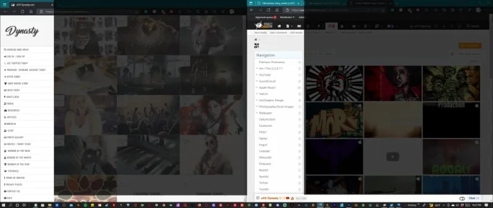

Would be amazing if we were able to add Html code to the titles of our XFMG
This would give us the option to add Font Awesome code to give the links a little more pop.
I do this on the splash page of my website and it gives my navigation more pop. :)
