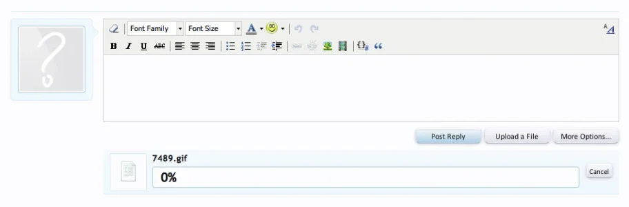

Upon attempting to upload with the flash uploader enabled the upload progress bar shows up, but no progress ever occurs. (See attached screenshot) It just stays at 0% indefinitely unless you cancel it. Uploads of the same images work fine with the non-flash upload method.
Within the JS Console the following is logged:
SWFUpload successfully initialized (SWFUpload_0)
Queued file FFU.jpg (33579 bytes).
Attachments changed, total files: 1, images: 1
Uploaded 0/33579 bytes.
All files uploaded.
