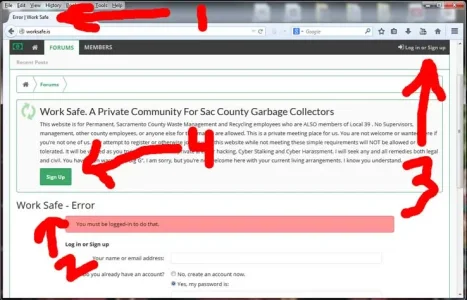

I have a private board set up at http://worksafe.is/ . This is a fresh install with UI.X theme I have an Error message showing on the front page. Plus the signup button doesn't work. It goes to http://worksafe.is/login/login . What is the normal url for the registration page. I have it set up so non-registered/guest are not allowed to view the board. But they still need to see a landing page with a proper link to register.
What am I doing wrong?
This is what I get and the issues I am trying to correct. It might be UI.X theme related also.
1. Top tab shows an error message
2. Page error message, but access to the registration page from the for below is possible.
3. Access to the registration page is possible.
4. This button doesn't get to anything usable /site.is/login/login. This takes me to another page where I get "This action is available via POST only. Please press the back button and try again."error_message.webp
#1 - Seems to me that is correct as it is actually an error. they cannot view anything until they log in.
#2 - See #1
#3 - To be expected
#4 - that login is in a notice and is style specific so you need to check the style
But don't take 1 & 2 as gospel as I don't have my site locked out to all users to make it a totally private site.
Not sure if you can point the home tab to a Page node with a simple message like the one you already have. If not a simple portal plugin would do that for you and make the index look a little cleaner. But as said before its a private site and users are trying to view something they have no permission to. That is a normal error when visiting a no permission section requiring the user to not be a guest.
As far as the signup button goes its pointed to the wrong url login/login will always error out when directly linked to. Fix that link and problem solved.

I can't figure out the url to the actual login/register page. Or where to edit the info. I have a message on the Audentio board also. I plan to go live ASAP and would like everything looking presentable for my launch.
http://worksafe.is/login/ If you right click on the login button that is stock for xenforo it gives you the fallback that would be the URL if javascript were not pulling down. login/login is the submit page and will always give that error.

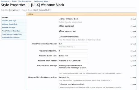

Set in your Style Properties if it is the welcome block.
This fixed the login button, thanks. Funny thing is, as far as I can tell, the reg. page is site/login/login like it was set. But when you just try and use the url it wont take you to the reg. page. It takes you to a message saying "This action is available via POST only. Please press the back button and try again." But at least the button now takes you to a login page. Thanks
If you right click and open in new tab on the login button at the top of the screen you will see it is /login/, /login/login is a post only page and you will never be able to access the login page from that. That is the page that the login page submits to.
