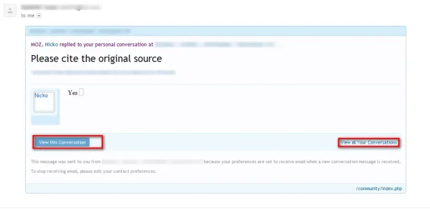

So while testing our upcoming forum, we noticed that all the emails the users received for their watched threads or conversations had links which were not clickable (Basically those in the red box below). So is this by design or is there a bug here.

When you say "not clickable" do you literally mean clicking on them doesn't work? Or do they take you to an error?

It looks like images etc. are blocked in that image. The links are probably being blocked too.
This is usually done by your e-mail program.

Have you configured your board URL in the admin CP? By the looks of it, you have set it as /community/index.php

I was thinking of the option in Admin CP - Options Basic Board Information - Board URL. I see at the bottom right of your screenshot it shows /community/index.php, but on my site it shows the full URL to my board. That is why I think you might have configured with a relative URL, but it should be full (http://www.yoursite.com/community) :)
EDIT:
It should not contain a trailing /, I did that when I originally set up my forum and that will also break your emails URLs

The Board URL is definitely wrong.
I think in the Admin CP > Basic Board Information you have the board set up as conversations or something, but basically your Board URL should be:
http://yourdomain.com/community
Currently I believe you have it set as /community or community
