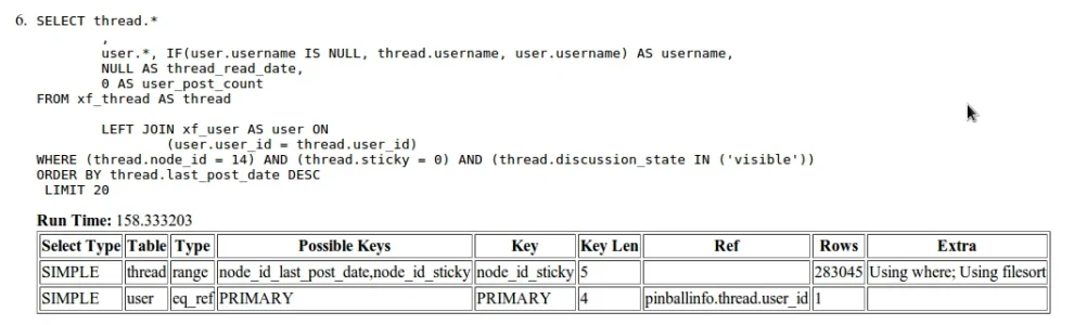

I'm no database expert, but it looks like a query is not hitting the desired index.

Interesting, queries 5 and 6 on my test instance are hitting the correct indexes.
Can you run
show indexes from `database name`.`xf_thread`;

Paul,
Can you do the above query for me, as Shadab as quite rightly pointed out, the query is not hitting the correct index.

MySQL doesn't want to use the "good" index here, as it thinks the sticky index is more selective. I'm actually looking at changing the index to (node_id, sticky, last_post_date), as this is used in both cases. (It might actually reduce the total number of indexes.)
Could the index cardinality be having an impact on the selection ? (Which is why I am interested in the output of show indexes)

Paul,
This will require a fix from Mike, your index cardinality looks fine, you are not swapping and memory is not being squeezed on the server.

Staff member
I've changed the index to the one I mentioned above and it does seem to help, though MySQL choosing to use it can still be a little off. A "USE INDEX" might be useful, though a definite pain to add. I think with bigger data sets (where it's important) it's more likely to use it anyway, so it's probably not important.

Paul
Mike,
Just wanted to say that the update has increased and improved the speed dramatically - from 43 seconds down to .47 :)
