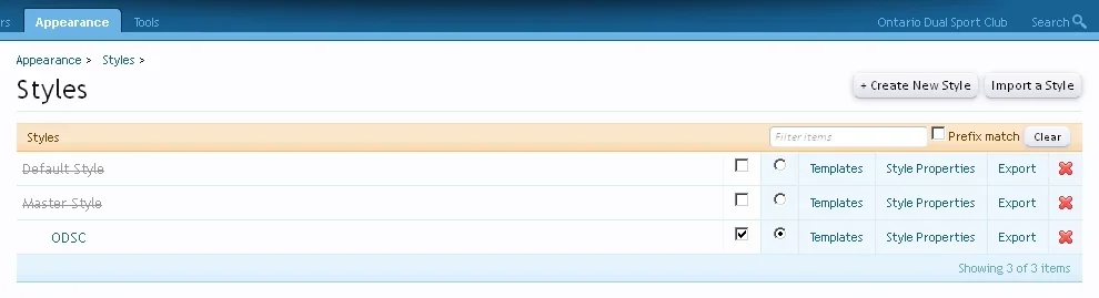

My test forum does not list a Master Style in the style choices (it used to). Somehow I have managed to remove it. All my TM core mods are in place and working. Everything looks fine as to the various customized components. The default style has never been altered so maybe it could be the basis for a master style replacement.
How does one restore the Master Style?
I see what's going on. I must have done some experimenting a long time ago and created a style called "Master". It shows when not in debug mode, but is not actually the master style. The real Master Style cannot be chosen as a style choice (correct way to have it).
Thanks Brogan.*
debug on
