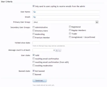

3. How can I email to a (multiple)group rather than an individual? I had this option in phpBB, but every time I select a group, it tells me no users were found.
ACP --> Users --> Email Users
Select the group via the User Criteria
Yeah, I tried that and it told me no users found.... I just tried now and it works >.> However, how can I tell it to send to multiple groups at once? I know that wasn't possible in phpBB, so I had a work around that I can try again.

Regarding #2, you can select group membership when creating the email, Registered should be the primary group for everyone, so just tick off the secondary groups you want to email too.

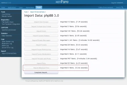

Alright... I just did a clean wipe to my directory and the database. Reinstalled XenForo and neither of those attachment folders were there, so I created them. Went through importing everything and this is what I get:
Why isn't it taking my files?
Where does it attempt to get my files from?
I tried looking for logs for the import, but I can't find it?

The folders are supposed to be the ones with your existing attachments in, not where you want your attachments to go. If you just create a blank folder, then you won't have anything to import and will get 0 imported items (as your screenshot shows).
This add-on should hopefully allow you to just undo and re-do that last step:
http://xenforo.com/community/resources/import-tools-by-waindigo.1255/

Wait, are you saying that I have to place my phpBB attachment files (/root/files/ as they are in phpBB) into one of those attachment folders? Or do I need to copy /"phpbb"/files/ to /"xenforo"/files?
They need to be on the same server and in whatever folder you have specified. So either copy all your attachments from phpbb into the directories you previously specified or start your import again and specify the correct path to your phpbb attachments folder.

Well, geez. That's nice to know. Guess they need to give more detail about that? Wish I knew that before wiping the setup more than three times >.>
Thanks for that addon. Trying it now.
