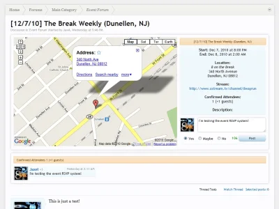

Jaxel
Okay, I couldn't get "load_class_view" working... but lets move on, I figured out a different way to do it what I was trying to do...
My next quesiton... I used "load_class_controller" to add stuff to the ThreadView, including an input form:
My next question sounds like it would have a simple answer, but I'm lost... With my input form:
  • where should I be sending the form action and how do I control it?
