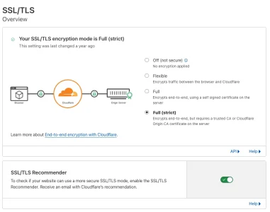

Do you use Cloudflare?
GuzzleHttp\Exception\ConnectException: cURL error 35:
The cURL error35 says always the same.
CURLE_SSL_CONNECT_ERROR (35)
A problem occurred somewhere in the SSL/TLS handshake. You really want the error buffer and read the message there as it pinpoints the problem slightly more. Could be certificates (file formats, paths, permissions), passwords, and others.

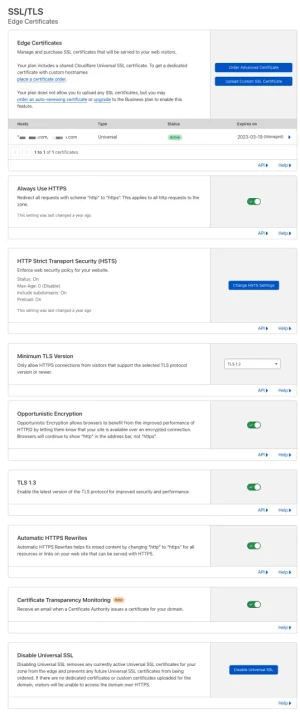

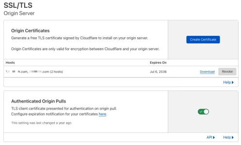

This is sometimes a big problem with Cloudflare. If i am right, there're are two certs if you are using cloudflare. First one between visitor and CF, and the second one between CF and the website/server. There is an option to use the same cert with cloudflare. But i am not a pro, it might be the issue.

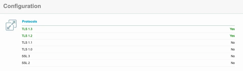

@Alpha1 you said that you use cloudflare. Can you say something about your SSL/TSL options at CF? Like these are mine and this add-on works fine.
