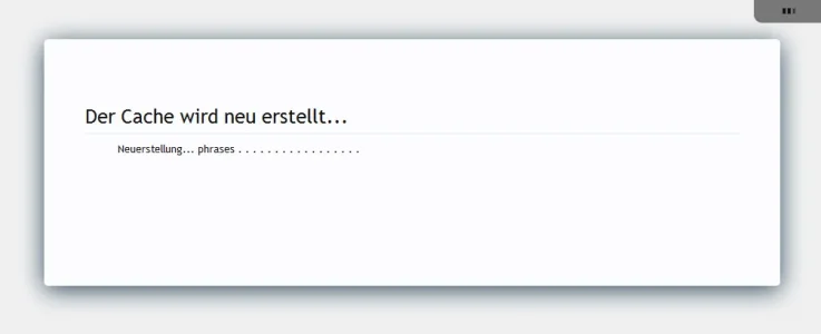

Hello,
I just moved my XenForo to another Host (to a VPS), and now i have only Proplems. First it tokes me 2 Hours to install XenForo. It always stucks on Creating Cache/Phrases. But ok, i could resolve this Proplem.
Next, i cant install any Addon. It stucks too on Creating Phrases. And now, my ACP Phrases are broken..WTF IS WRONG with my XenForo?

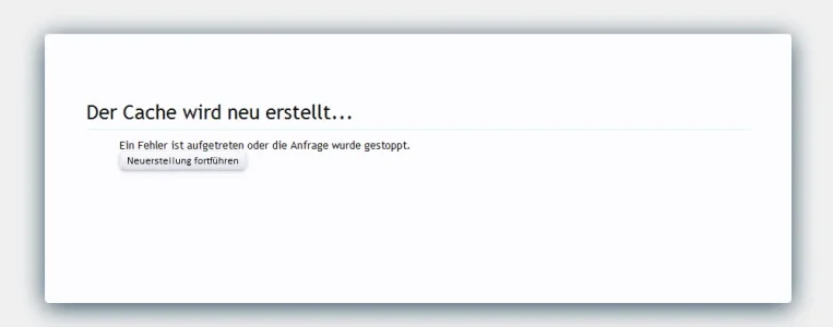

Now i cant install XenForo anymore: An error occurred or the request was stopped.
What should i say to my Host, what is wrong, is it a MySQL Proplem, or Apache ...

Sorry, i dont have XenForo installed anymore, because i deletet everything and tried to install it again. But it dont work, it stops with an Error: An error occurred or the request was stopped.
So, the Thread Titel should be chanced to: "Cant install XenForo" :p
