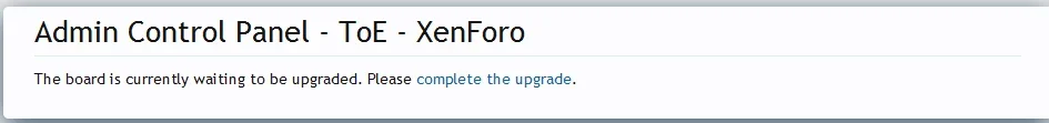

Update: If I click on another link in the adminCP, it gives me the attached screenshot:
After selecting "complete upgrade", the upgrade continued/completed.

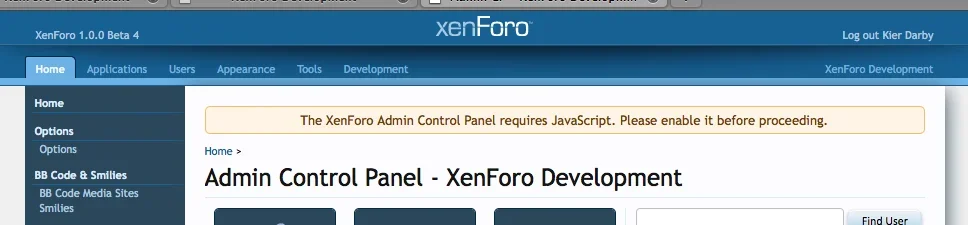

Is javascript disabled in your browser? The Admin CP requires javascript.
With javascript disabled it's possible to expose the POST action with a failed login attempt. The POST action then becomes the redirect location following a successful second login attempt. I was able to reproduce this on my forum. Though I'm not sure this qualifies as a bug since the Admin CP specifically requires javascript.
