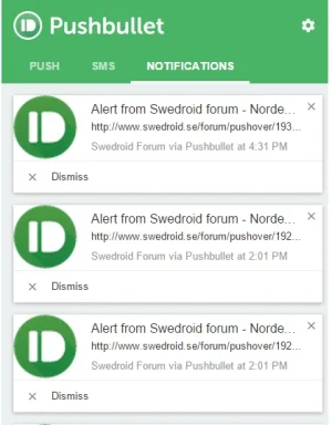

It looks like this for me. This is with the Chrome pusbullet addon, but it looks the same with the pusbullet app on Android. I get the same amount of information. A notice about an alert and an URL+timestamp. That's it.
Is the information maybe a part of the headline? Because that gets cut out after X characters it seems.

It looks like the prefix is too long and didn't make room for the rest of the alert, you can delete the content of the phrase bdpushover_alert_from_x to remove this prefix.
That did the trick! Thanks.

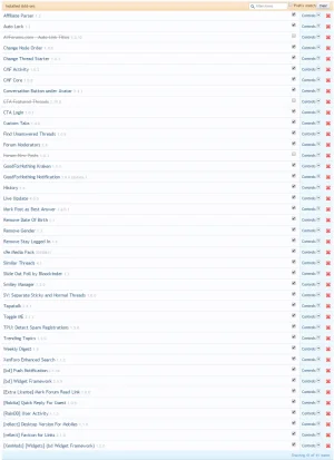

I just received the same error. First time for me since I installed the add-on a few months back. I have not recently installed or updated any add-ons (at least for a couple of weeks).
