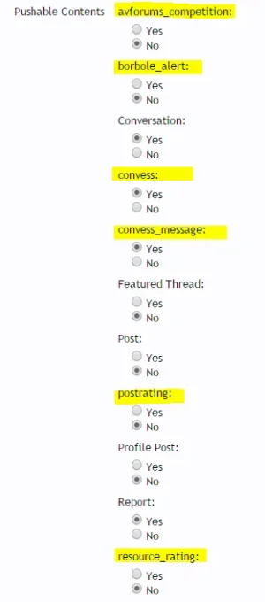

How do I update these (highlighted below) coming from /admin.php?options/list/bdPushover ?
For each of the texts, you can create a phrase to display it correctly or you can disable it from being pushed (so users won't see the alert type in their option page).
