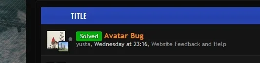

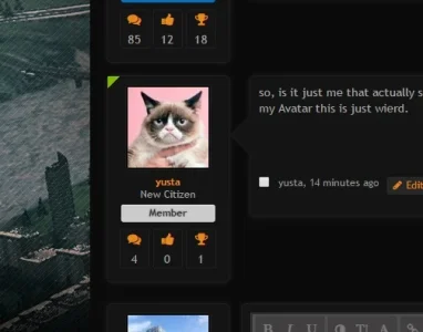

Seems to be some weird avatar problem on one of my members profile. I've selected a new avatar for him (the cat), which is visible in thread view, but I see his old avatar in forum view (for example on alerts or in the recent posts widget).
If I delete his avatar, it still doesn't go away (the old one).

@ Maru: We are both seeing the same problem.
@ Mike: Deleting it does remove it, but when I try to add a new one, his old keeps on re-appearing..
In /admin.php?users/yusta.xx/edit I see his old avatar, in admin.php?users/yusta.xx/avatar I see his new.. Weird.

s folder: 48 * 48 version. Correct avatar. (which is odd, as this is the version being showed in widgets/online users etc, and is pulling the old avatar.)
I have Gravatar avatar, so I don't pull from my avatar folders, but it works when I test with a local version.
EDIT: Fixed it. Did 777 CHMOD on everything again, then cleared cache and forced purge of CDN cache, and it works now :) So probably was just CHMOD/cache problem.
