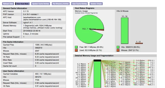

Also, install the apc.php script that comes with APC so you can see what the cache is actually doing.

We're on lightspeed and I think we're using DSO (will have to check again). I've access to apc.php; which settings/area should I look at?
That will tell you how long APC has been running for. If APC keep restarting, then it will be flushing all the session information out.

It continued to throw me out of the board. I noticed that the 'Uptime' as reported in the apc.php is '0', but it continousouly shows the memory allotment changing.

I haven't had any problems with it. Granted, most of my "users" are spammers trying to hit - but I would figure if it was unstable it would still rare it's ugly head.
