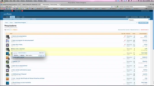

Selecting 2 threads on first page;

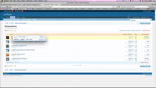

Moving to the second page and selecting another thread;

I just tested that here and it works fine.
