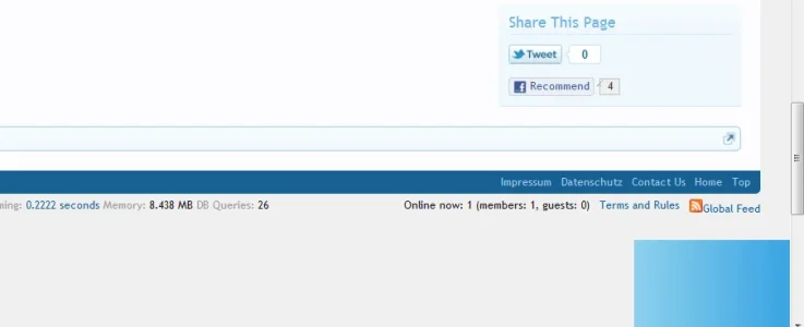

Oh, do i need a fixed style for this?:D
Ok then i've found the problem
